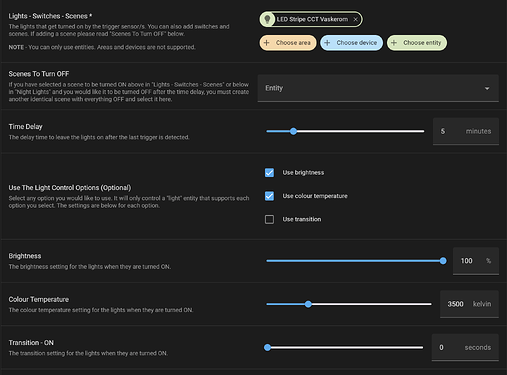

Thank you for your continued effort on this automation @Blacky. Things are running well here except for a couple of LED strips with Warm White/Cold White (temperature) control. The light entity is working perfect when controlling it manually - but neither the brightness value or temperature value is controlled by the automation. I have it set to have one brightness/temperature during daytime (100%, 3500K) and one brightness/temperature during nighttime (10%, 2700K).
The LED strip is turned on/off as expected but as mentioned the brightness/temperature is not adjusted. Any hints would be greatly appreciated.
Here’s the config for the light entity (combines a CW and a WW strip into 1 light entity with temperature/brightness control):

Here’s a couple of screenshots from the automation:
That got it. Thank You so much! I appreciate your help!
