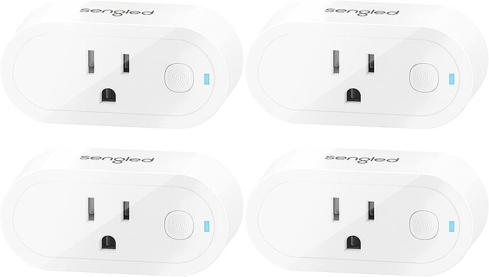

Good to know about the 4th gen Echo devices. I’ve also got a bunch of zigbee smart plugs that are supposed to be repeaters. I have at least one of these in every room and in the garage:
Hopefully, these will play nice. I’ll also order one of the Sonoff ZBDongles. Thanks for the heads up.
