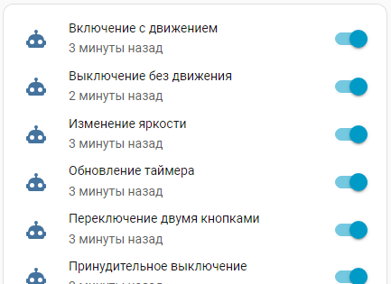

Thanks. My code:
type: custom:auto-entities
card:
  type: entities
  show_header_toggle: false
filter:
  include:
    - entity_id: "automation.hallway_*"
      options:
        eval_js: true
        name: "${ ((state.attributes.friendly_name||'').split('(')[1]?.split(')')[0] || state.attributes.friendly_name).trim().replace(/^./, c => c.toUpperCase()) }"
        secondary_info: last-changed
  exclude:
    - entity_id: "automation.hallway_manual_mode"
sort:
  method: name
great you got that working.

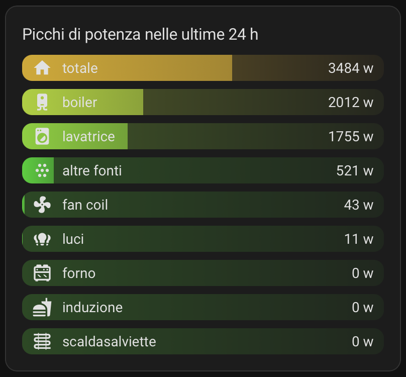

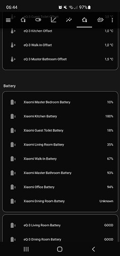

Hi guys.
If anyone wants to see the same result achieved above by many other users, below I’m sharing my examples.
The card is visually almost identical to others already created (I mostly copied the beautiful gradient from you guys above), but it differs in the use of custom-button-card.
The difference is that:
  • instead of using auto-entities with entities inside it — a solution that necessarily requires card-mod
  • I used auto-entities with custom-button-card inside — a solution that does not require card-mod and opens up the extensive configuration possibilities offered by custom-button-card
(the maximum value of the bars is 6000 because that’s the capacity of my electrical meter.)
Example 1 (auto-entities + entities + custom-button-card)
Code:
card:
  type: entities
  title: Picchi di potenza nelle ultime 24 h
  card_mod:
    style:
      hui-sensor-entity-row: null
        .card-header {
          font-size: 16px;
          padding-bottom: 12px;
sort:
  method: state
  numeric: true
  reverse: true
filter:
  template: |-
      {% for e in states %}
        {% if "sensor.teatrino_1_blu" in e.entity_id and "picco" in e.entity_id %}
          {# nome e icona #}
          {% set dizionario =
            {'nome':'boiler','icona':'mdi:water-boiler'} if 'boiler' in e.entity_id else
            {'nome':'fan coil','icona':'mdi:fan'} if 'fan_coil' in e.entity_id else
            {'nome':'forno','icona':'mdi:stove'} if 'forno' in e.entity_id else
            {'nome':'induzione','icona':'mdi:food'} if 'induzione' in e.entity_id else
            {'nome':'lavatrice','icona':'mdi:washing-machine'} if 'lavatrice' in e.entity_id else
            {'nome':'luci','icona':'mdi:lightbulb-group'} if 'luci' in e.entity_id else
            {'nome':'scaldasalviette','icona':'mdi:heating-coil'} if 'scaldasalviette' in e.entity_id else
            {'nome':'altre fonti','icona':'mdi:dots-hexagon'} if 'altre_fonti' in e.entity_id else
            {'nome':'totale','icona':'mdi:home'}
          {# valore #}
          {% set valore = states(e.entity_id) %}
          {% set valore = valore | int if is_number(valore) else 0 %}
          {# sfondo #}
          {% set val = states(e.entity_id) %}
          {% set val = val | float if is_number(val) else 0 %}
          {% set perc = (val/6000*100) | round(1) %}
          {% set perc = 0 if perc < 0 else perc %}
          {% set perc = 100 if perc > 100 else perc %}
          {% set rest = 100 - perc %}
          {% if perc <= 10 %}{% set bar = '51, 255, 0' %}
          {% elif perc <= 20 %}{% set bar = '102, 255, 0' %}
          {% elif perc <= 30 %}{% set bar = '153, 255, 0' %}
          {% elif perc <= 40 %}{% set bar = '204, 255, 0' %}
          {% elif perc <= 50 %}{% set bar = '255, 255, 0' %}
          {% elif perc <= 60 %}{% set bar = '255, 204, 0' %}
          {% elif perc <= 70 %}{% set bar = '255, 153, 0' %}
          {% elif perc <= 80 %}{% set bar = '255, 85, 0' %}
          {% elif perc <= 90 %}{% set bar = '255, 51, 0' %}
          {% else %} {% set bar = '255,0,0' %}
          {% endif %}
            "type": "custom:button-card",
            "entity": "{{ e.entity_id }}",
            "icon": "{{ dizionario.icona }}",
            "name": "{{ dizionario.nome }}",
            "label": "{{ valore }} w",
            "show_label": "true",
            "tap_action": "none",
            "hold_action": "none",
            "double_tap_action": "none",
            "styles": {
              "card": [
                  "border": "none",
                  "border-radius": "10px",
                  "padding-top": "3px",
                  "padding-bottom": "3px",
                  "padding-left": "10px",
                  "padding-right": "10px",
                  "font-size": "14px",
                  "background": "linear-gradient(to right, rgba({{bar}},0.8) 0%, rgba({{bar}},0.6) {{perc}}%,rgba({{bar}},0.2){{perc}}%, rgba({{bar}},0.05) 100%)"
              "grid": [
                  "grid-template-areas": "'i n . l'",
                  "grid-template-columns": "min-content min-content 1fr min-content",
                  "grid-template-rows": "min-content",
                  "column-gap": "10px"
              "icon": [
                  "width": "20px",
                  "height": "20px",
                  "color": "var(--primary-text-color)",
                  "transform": "translate(0px,0px)"
          {% if not loop.last %},{% endif %}
        {% endif %}
      {% endfor %}

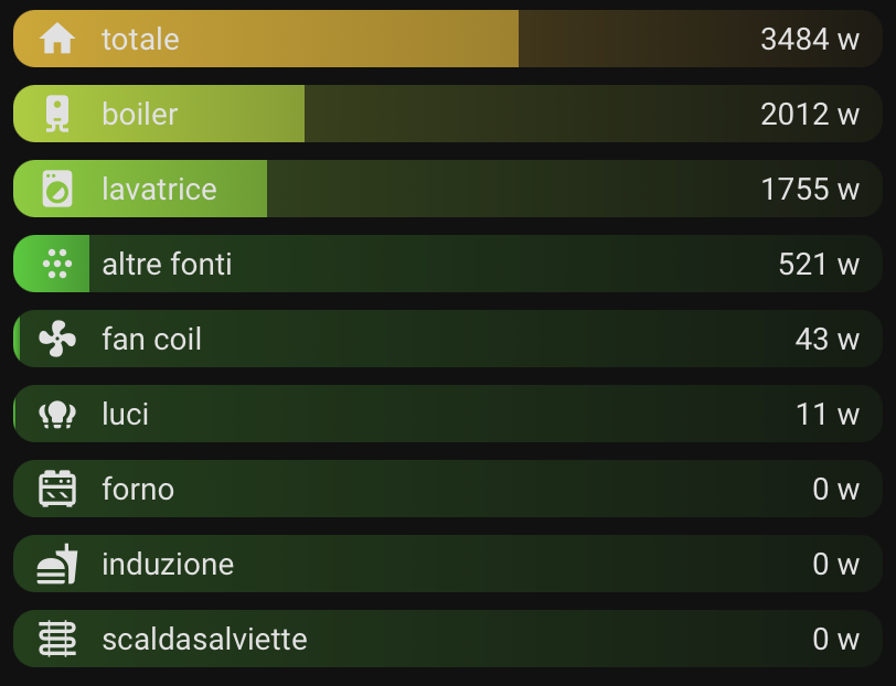

Example 2 (auto-entitities + vertical stack custom-button-card)
Code:
card:
  type: vertical-stack
card_param: cards
sort:
  method: state
  numeric: true
  reverse: true
filter:
  template: |-
          {# nome e icona #}
          {% set dizionario =
          {# valore #}
          {# sfondo #}
          {% endif %}
            "styles": {
              "card": [
                  "border": "none",
              "grid": [
              "icon": [
                  "width": "20px",
                  "height": "20px",
        {% endif %}
      {% endfor %}

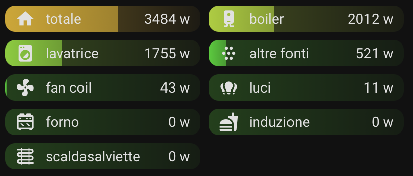

Example 3 (auto-entities + grid + custom-button-card)
Code:
card:
  type: grid
  columns: 2
  square: false
card_param: cards
sort:
  method: state
  numeric: true
  reverse: true
filter:
  template: |-
          {# nome e icona #}
          {% set dizionario =
          {# valore #}
          {# sfondo #}
          {% endif %}
            "styles": {
              "card": [
                  "border": "none",
              "grid": [
              "icon": [
                  "width": "20px",
                  "height": "20px",
        {% endif %}
      {% endfor %}
