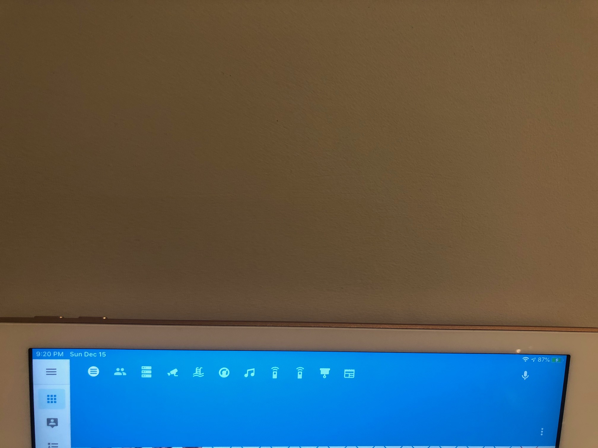

I’m having issues with the iPad app as well. The header is overlapping like in my photo:
I remember this being some sort of issue that might be the fault of “layout-card” instead of custom header, but in this case it works fine in a browser, just not the ipad app.

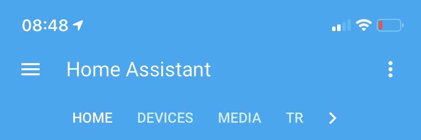

I get a lot of these in the logs, even after restarting HA:
https://tcc.bla.bla/community_plugin/custom-header/custom-header.js:576:42260 TypeError: undefined is not an object (evaluating ‘_.voice.style’)
https://tcc.bla.bla/community_plugin/custom-header/custom-header.js:576:42389 TypeError: undefined is not an object (evaluating ‘_.voice.style’)
And the header gets shorter on my iphone (HOME DEVICES MEDIA TR), it’s not using the full width:
When disabling the plugin (or use disabled_mode:true) it looks much wider:
