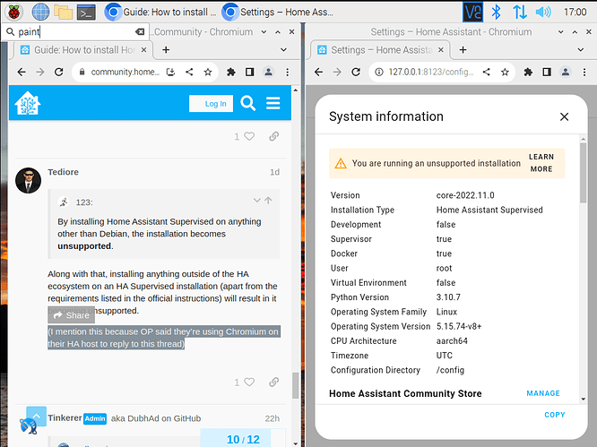

Good advice. The information Tinkerer has presented, that wasn’t included in your installation instructions, is important for their research. Some users may decide that they want a supported system and so will choose to install Debian.
Along with that, installing anything outside of the HA ecosystem on an HA Supervised installation (apart from the requirements listed in the official instructions) will result in it becoming unsupported.
(I mention this because OP said they’re using Chromium on their HA host to reply to this thread)

Dear @Tediore,
In here I provide you with one image that shows how I am using Chromium in the same Rpi4 where I host Home Assistant Supervised.

I didn’t say you’re not using Chromium on the same Pi that you are running HA Supervised on. I said that installing anything outside of the HA ecosystem on an HA Supervised installation (apart from the requirements listed in the official instructions) will result in it becoming unsupported.

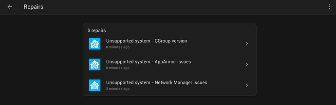

@valkanoise Hi, nice guideline.
I’ve followed step by step your guidelines on my RPI 4 with SSD, and unfortunatelly it doesn’t work for me.
I still receive the errors. See attached printscreen.
So far I tried a lot of methods based on Raspberry PI OS and I tend to believe that Debian 11 no derivative recommendation is true. Looking forward your oppinion.
The ADR aren’t recommendations, they’re requirements. As has been said many times, if you ignore them you are going to have problems.
