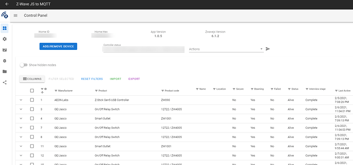

  7. Open the Web UI
  8. Paste information into ZWave JS UI configuration area.
    Note: Add the network key you noted as S0 legacy and generate 3 new keys for the other three keys.
  9. Watch the device list and wait for the last node to be found.
  10. Fix all 'unknown' devices by waking them up. No need for a refresh node, just wake them up.

Hi all. Thanks for the awesome guide. I was doing OK - my light switches came right back and I was able to rename them and re-do my automations.
I have 3 garage door tilt sensors. 2 came up after some time and the Interview Stage shows as being “Complete.” However, the third one seems to be stuck at “ProtocolInfo”. Any thoughts?
I’ll confess, I did something out of order - I renamed the device in HA before it completed the Interview. Is that a problem? I forgot that the Z-Wave JS integration page says “Once a node hits the ready state, the entities will be created (so not before). Only at this point, is it safe to rename the device (and so its entities).”
Do I need to re-do everything? Or any other ideas on why my sensor isn’t advancing in the Interview process?

FYI, I have gone into the control panel (WebUI) and tried “Re-interview Node” and “Refresh values” a couple times. It does seem to restart the Interview but hasn’t advanced past “ProtocolInfo.” Finally, I did manually wake the switch (and it said “Awake” under Status), but it did not advance.
