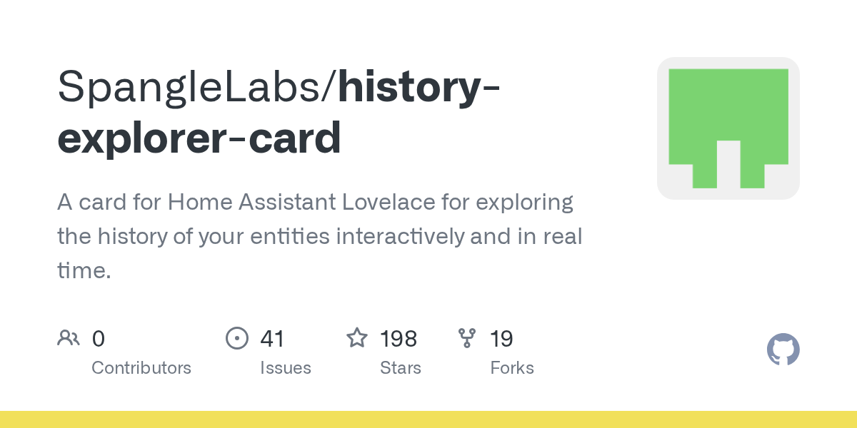

[Under New Management] Interactive history explorer custom card
The version built by @HeyImAlex has been deprecated, but a new verison has been taken over by @SpangleLabs
