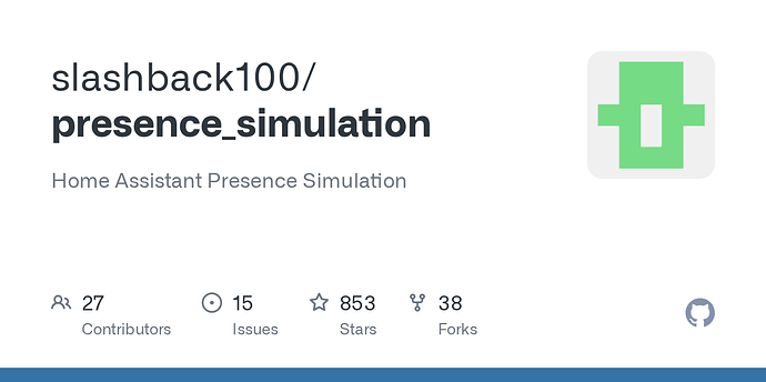

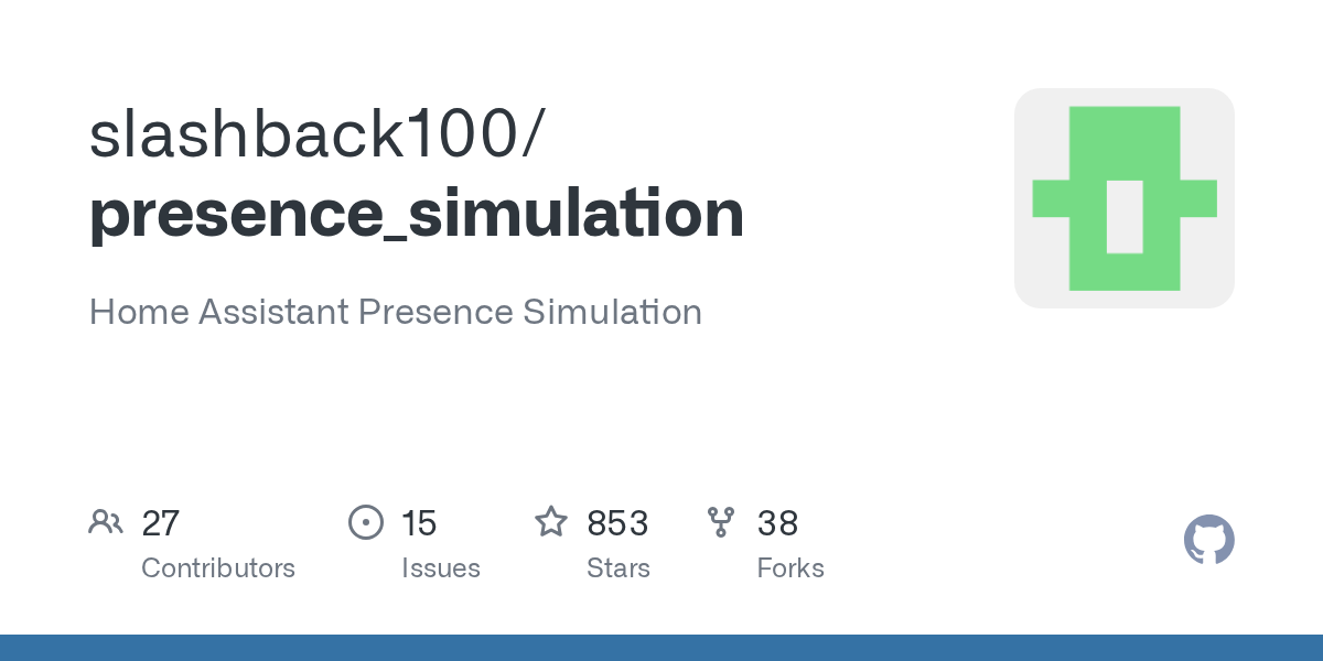

Not to hijack a probably great blueprint.
But why reinvent the wheel? :wink:
This integration works great to mimick the regular “presence” and is activated with a simple gone from home automation :+1:
@paschaef
Welcome to the community. I sort of designed it to work with my sensor light blueprint. There you can set all the light options, but I get what your saying. I will add it to the list to do.
Blacky :grinning:
@rodak
You can use that type of option, I even had a blueprint that worked the same way. The drawback is that if you’re away for the night and forget to turn the lights ON beforehand, then nothing will replay, which I didn’t find very useful. My approach is different: it’s designed to work alongside my sensor light blueprint, and you can also include more lights than you’d normally use, giving you extra flexibility.
This isn’t like that integration at all, no one else is doing it this way and you to can “activated with a simple gone from home” toggle. The main goal is simply to make sure lights turn ON and OFF when you’re away. In the end, it’s about what works best for you, there’s no requirement to use it.
