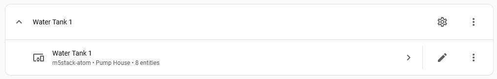

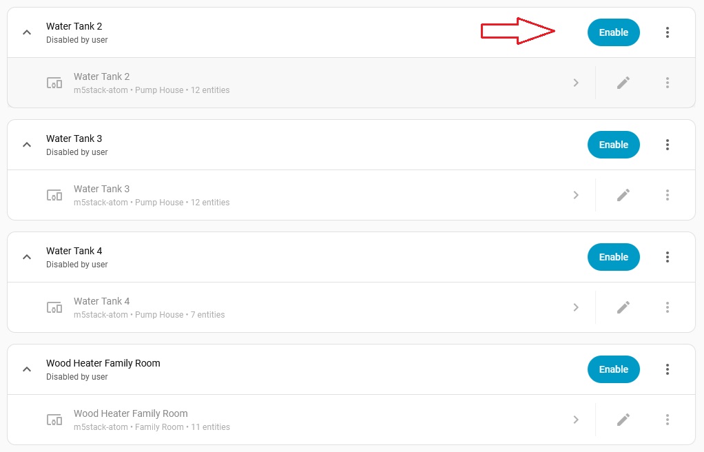

Below is an example of an ESPHome device that has been disabled. When a device is disabled, you will see an Enable button.
If the device is enabled, you will not see an Enable button, as shown below.
If your devices are disabled, you will need to enable them before they can be selected in the Included ESPHome Devices or Excluded ESPHome Devices inputs.

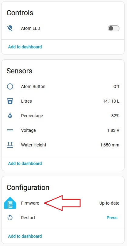

Finally the last step to check. In the ESPHome integration, open one of your devices and, under Configuration, check if you have Firmware listed, as shown in my screenshot below. This entity must also be enabled.

That is strange. Could you check one more thing for me?
Below is my ESP32 for my water tank. I must say, it is incredibly accurate and works so well… I love ESPHome!
Blacky :smiley:
So that’s probably the problem—I have this sensor disabled on all my Esphome devices…
As soon as I enabled the sensor, the device appeared.
I don’t use that sensor so I don’t get unnecessary update notifications. I keep track of that myself.
@pksoft585
Thanks for letting be know. Good we finally found it.
Maybe just enable the ESP devices you would like to update then the blueprint will update them automatically so you wont see the update notification for long.
