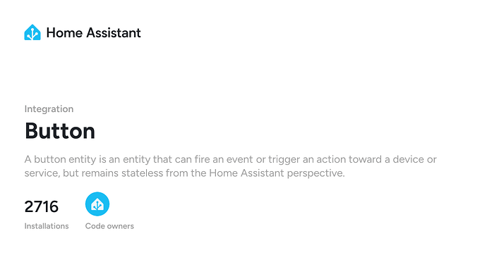

Buttons
Having said all that, buttons are an oddity. They do not have a state. A button press is an event - it doesn’t remain on or off. The entity does, however, retain a timestamp showing the last time it was pressed and this becomes its state, allowing it to be used as an automation trigger when it changes.
